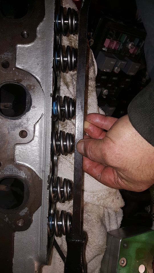

ive seen as much as .010 disparity between stem heights even on lower mile OEM heads. the worst was the IS3/IS4 heads for the Riv....with VSR on the exhausts causing us to get 3 different length pushrods to get between .010-.020 lifter preload. bronze guides were in fine shape when we got em with about 10k miles.
far too often i see folks dont spend enough time to scrub parts down, and are still in the "a dab of white lithium grease" lubrication camp.
my "customers" are lucky if i dont use two cans of brake cleaner per head....after scrubbing with kerosene. a high moly assembly lube, spread through the guide to make sure all lube reservoirs are full before slapping the valves in.
dipping the end of the valve and sliding em in doesnt work quite the same.
lol @ the core shift
