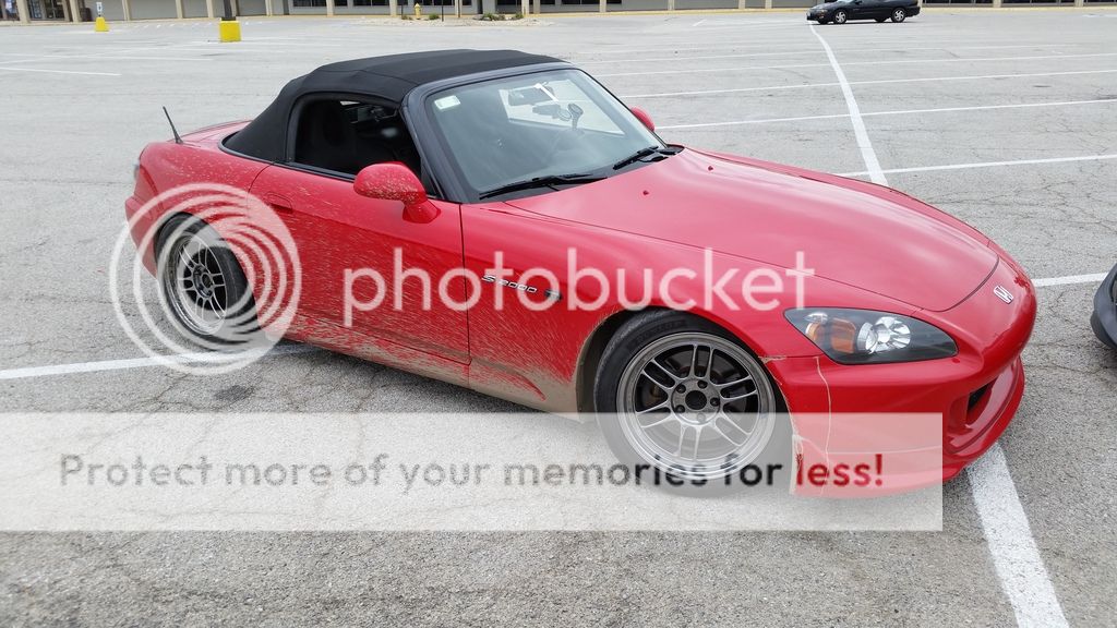

I used to care a lot about rock chips getting in my car, and rubber marks all over the front. I've gotten over that, I track the car too much to care about that. It's still dent free, not a single dent in the car at all, so I would probably kill whoever puts the first dent in it, but I'm over the rock chips. I even take it off road every once in a while. YOLO.
