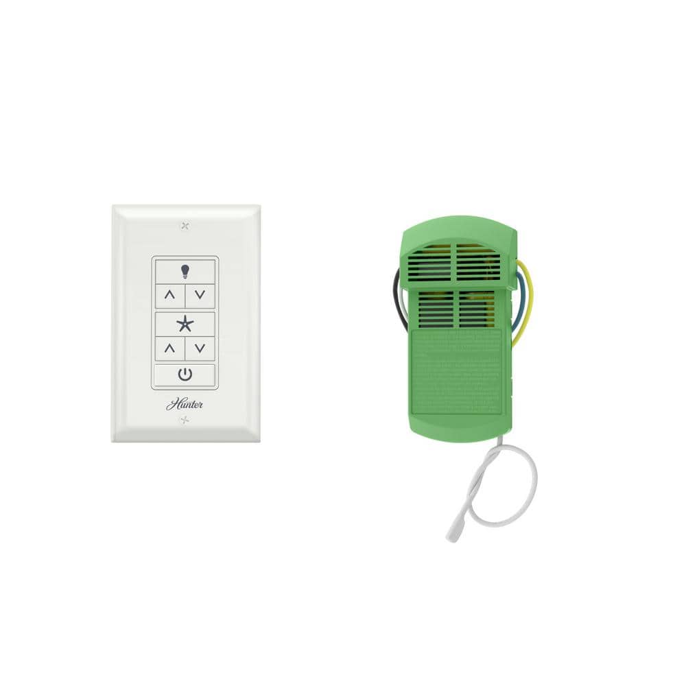

Get a wireless fan control unit that mounts to the wall switch location. Fans are 2 or 3 wires depending on if the house was pre wired for a fan with a light, with the wireless control you can bridge the light and fan control into the same power lead and get fan speed and light dim control off a 2 wire system.

Ceiling fan wall remote, easy to wire and the 3 I have in my house work flawlessly with the Hunter fans they’re wired to. Can adjust fan speed and dimmable lights. There are other models by Hampton Bay but from experience those are trash and they don’t look as good.
