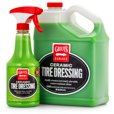

Has anyone used this Griots Garage Ceramic tire dressing?
I've been using meguiars endurance gel for YEARS.
A little bit of this really goes a long way. I use very little and just work it onto the tire until its all evenly (thinly) coated. Puts a nice shine on the tire and it will last awhile, especially on cars like my GTO that don't go outside every single day. And if you put it on the right way and let it sit before you drive nothing slings off onto your paint either. This shit will last you forever. It's not water based or anything so it can get a little greasy, but it cleans off easy enough with a decent wheel/tire cleaner like brake buster and a good tire brush

I've been using Ultima Tire and Trim Guard for a few years and I love it.
Never greasy, doesn't fling, gives a nice natural look. I've had the same bottle for years as a little goes a long way. I applied it to my bike trim going on 2 years ago and it still looks good and is hydrophobic as hell.
