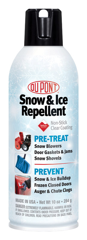

I have been in charge of my moms snowblowers ever since she got divorced. This means im the guy winterizing and summarizing them. Few years ago in the fall I replaced the plug, mixed up some fresh gas and oil and got it ready for her. Saw this Dupont snow blower spray at the store and said can't hurt right? Well ever since I sprayed that shit the blower seems to clog up very easy. Few inches of light snow cogs, heavy wet snow, forget about using it at all. Anyway to make it work like it used to or is it junk? I cannot imagine it just started running like shit on coincidence right after I sprayed this stuff.

I have used PAM as well in the past, same thing, Costco cause you're going to use it liberally. Last season I got bored and coated my chute with some old paste car wax, then topped it off with some finishing spray. Not even fresh dog shit would stick to the chute. Time and effort vs. effectiveness and longevity, go with the spray though.

I've used Silicone Spray for years and it works great. Put it on the shovels too.
However, that DuPont stuff is Teflon fluoropolymer and silicone which in theory should be better.
If it's a single stage blower, check the augers for wear.
I had the same clogging issue when my augers wore out and it didn't matter how much silicone I used then.
Most augers have wear indicators on them, but yours might be past those already if it's clogging bad.
