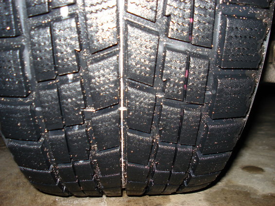

your tire vs snow tire.... see a difference?
and yes dasfinc they do handle amazing :D

The ws50's are overkill for this area. I used them last year new and they had a little more than a 1/16th tread left after winter. They have a super flimsy side wall which you can notice on dry road lane changes. They like to squirm on the dry and don't like rain. When the temps go above 40F like they normally do here in the winter the tread wears fast.
They do love snow and lots of it. I swear they actually ate the snow they drove through. They handle amazing IN the snow.
For this area a V rated performance snow tires like the blizzak LM22 or Dunlop winter sport M3, will do perfectly well and leave you with much better rain manners. Not to mention the dry road driving.
I'm running a set of Vredestein Wintertrac Xtreme which have performed just as good as the WS50's. They are similar to your V-rated winter tires. Though I wouldn't try to take on roads with more than 6 inches of snow on them (undercarriage clearance is less than that), I can go through snow up to my side moldings just fine .
This pic gives you a good idea how soft the WS-50's get with water and warm temps.
