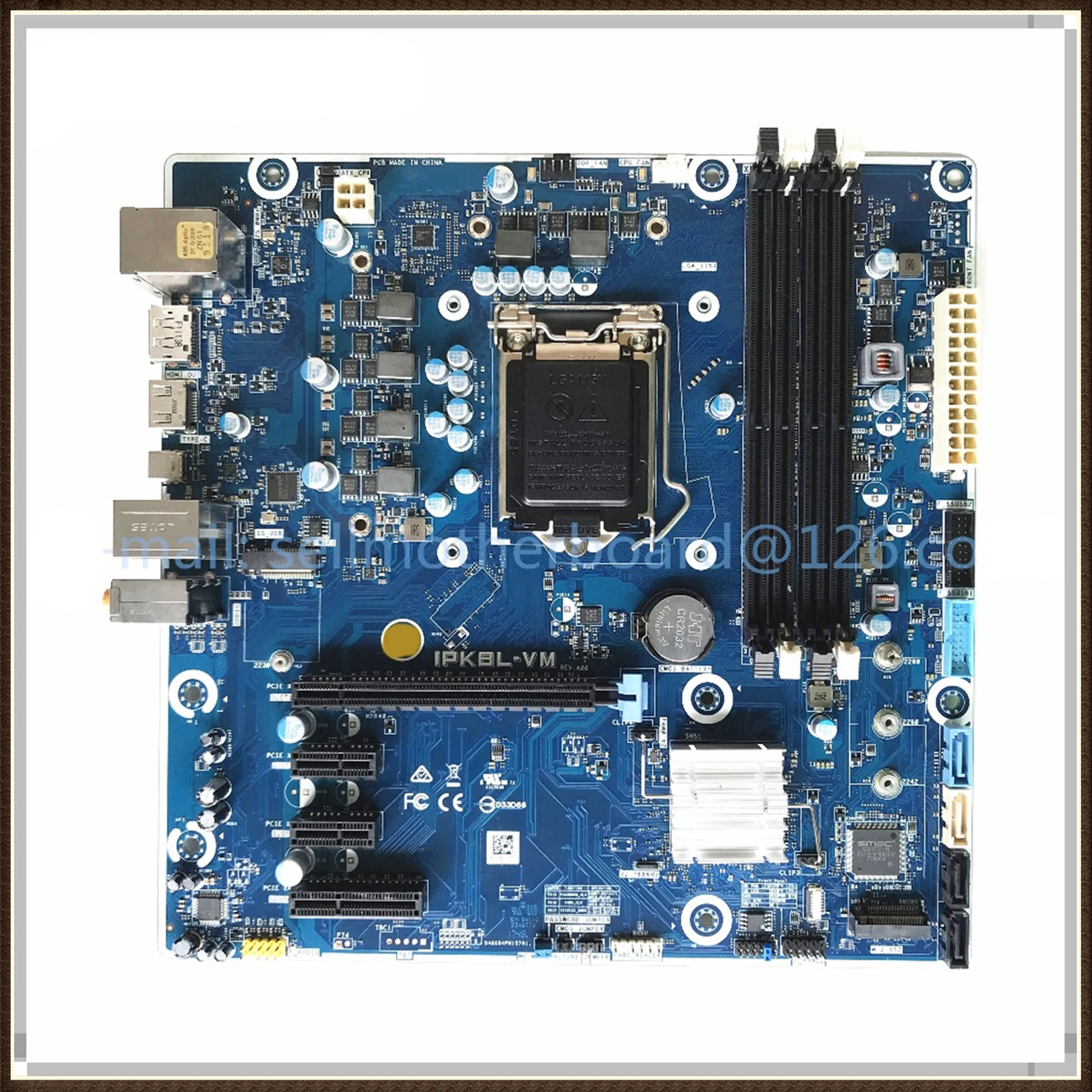

After looking at some pictures of the MOBO, Im sure its fine, but leaves much to be desired. It has M.2 slots if you wanted to upgrade your boot drive and that might help a little bit. The PCIE lanes might be enough for a GPU and M.2 drive.
I found a pic here.
Learning and messing with PCs is probably some of my favorite stuff now and learning more is always fun. I would honestly wait a few to see what is unveiled by AMD and see how board partners and NVIDIA respond to the 30 series issues before making a solid decision.
