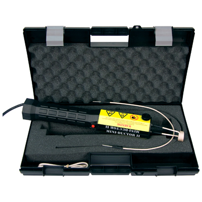

Heat. Lots of it.
I recommend a flameless heat gun. When I tried removing my leaf spring bolts(big ass M14x1.25x120mm bolts that go into the unibody) they would not budge with a 1/2" impact on it. The guys at the auto hobby shop gave me that flameless heat gun and after getting the bolt head red hot, the impact took them out like they were brand new.
Here we go, found it.
Induction Innovations Mini-Ductor II
