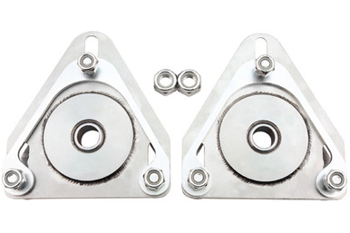

Will be using these camber plates.
I already have the front strut spacer kit from Steeda for the stock upper strut mount, but they offer a spacer kit made for their camber plates. The only part different in both kits is the stud plate, so instead of buying the entire kit again, I called their tech support and bought the stud plates over a week ago. Apparently this takes time for someone to pull the stud plates from stock...lol. Anyways, this is essentially the Steeda spacer kit I will be using.

Not sure yet, but I want that option. My blue car I felt was just a hair too low in the front so we’ll see how this car sits and if I need to adjust, I can.
I normally mix and match bmr springs to fix this, very common with whipple cars being too low due to weight on the nose. They list a spring set to help level out cars with blowers with some pictures. Im not sure which ones you got, but i do keep a lot of BMR stuff in stock for the S550, as well as springs if the camber spacers dont get you want your looking for

I went with the BMR Performance springs.

That almost looks like the front is higher by just a touch. This is why I bought the Steeda spacer kit. I’ll be able to dial it in perfectly.
