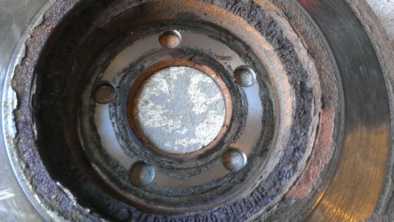

Passenger rear rotor, they all look the same so only one pic before installation

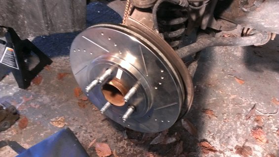

Looks like I'm in for a serious case of heating and beating these puppies to come off. That didn't do the trick so I had to use that trick in the youtube video that requires the 1/2"x3" bolt and 2 nuts. It popped right off
http://www.youtube.com/watch?v=mtsTJCRljAs
It almost looks like the old rotor was glued on!
You can see the rust flakes on the ground due to so much work from the 8 lb sledge and the rust breaking from doing the bolt trick.

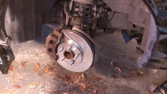

Pads are on!
Driver's side all back together!

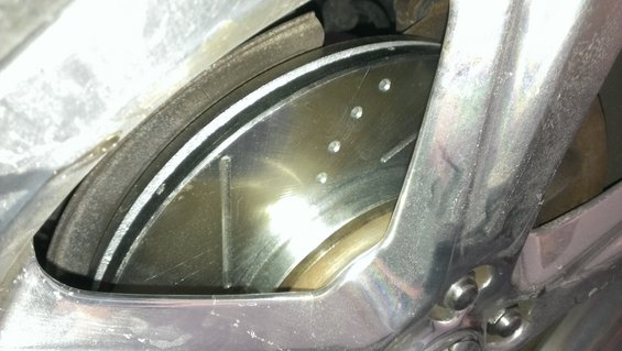

Got the wheels back on!
Close up of rotor, ignore my horrendously dirty wheels, they've since been cleaned and polished
Thanks for looking! The rear rotors proved to be a little more troublesome. I soaked them in PB Blaster and let it soak overnight. Went out in the morning to check, and a missed swing with the sledge resulted in dislodging a wheel stud. WHOOPS! Sprayed it some more and let it sit while I went to work. Got home 8 hours later and they practically fell off. I'll be painting the calipers in the near future as well. Can't decide between the old standby of red or go with something a little more unique.
