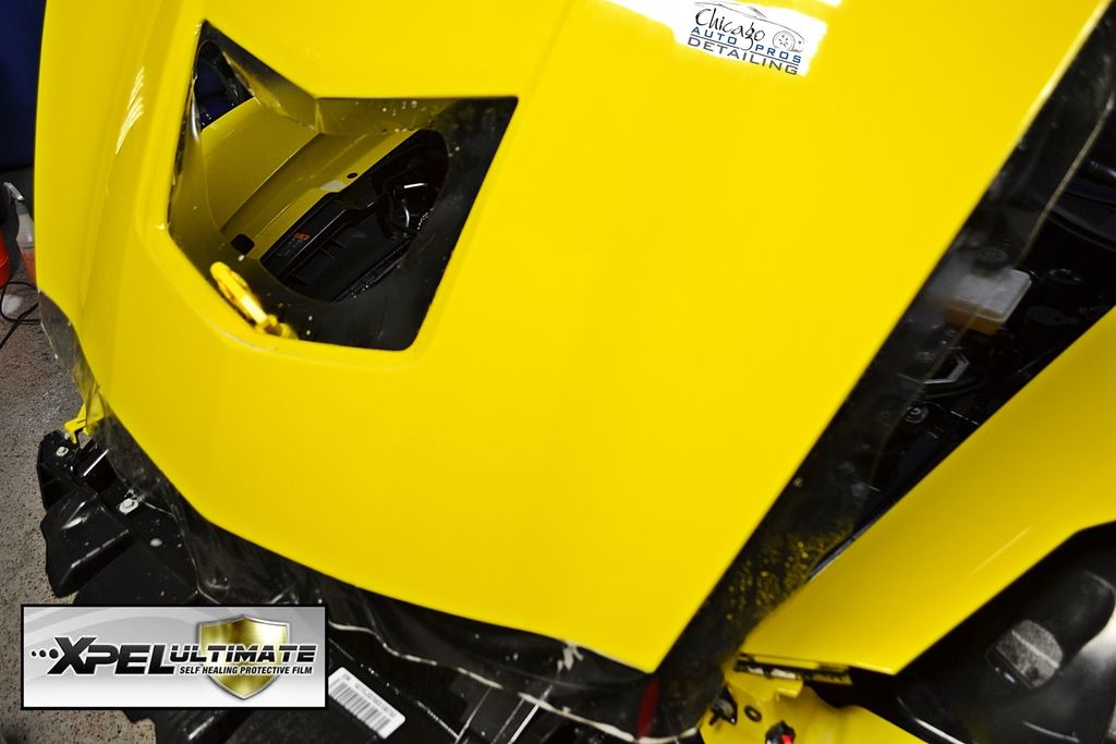

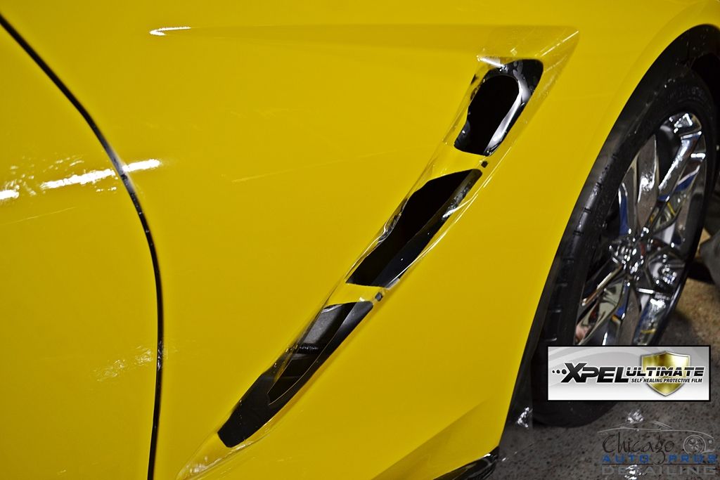

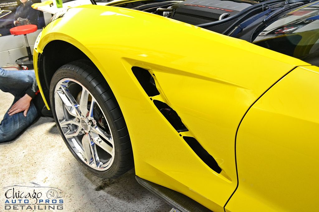

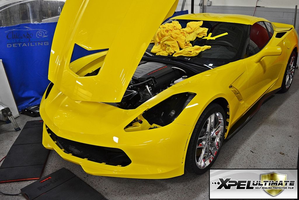

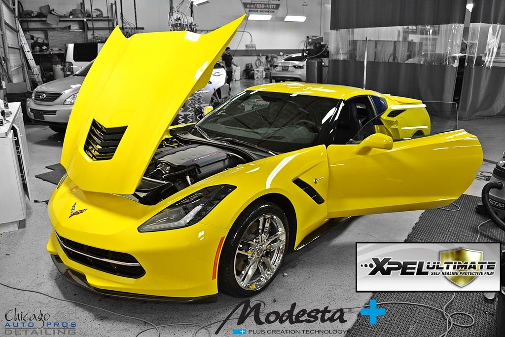

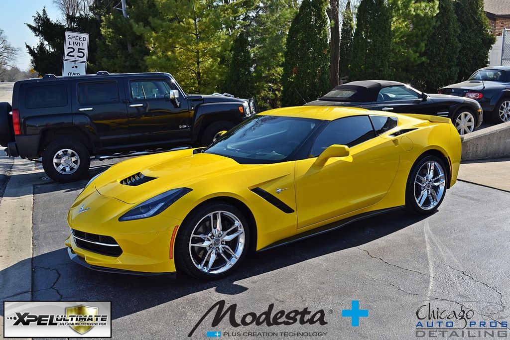

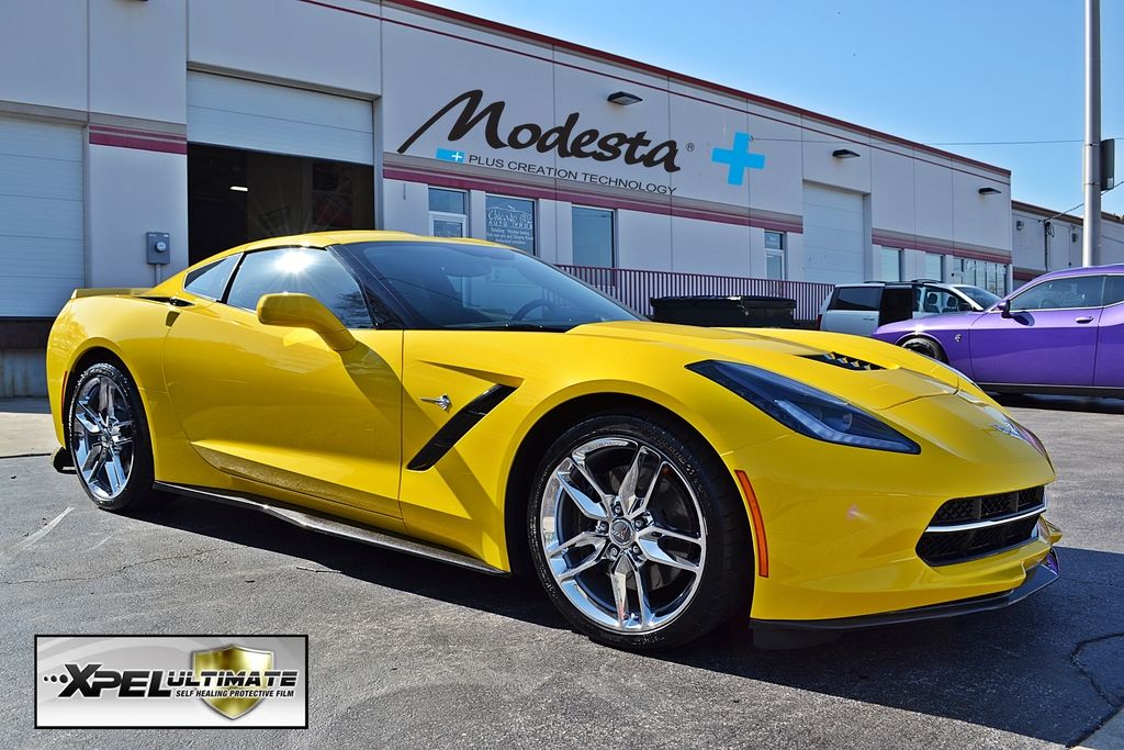

So last week at Chicago Auto Pros we were asked to rise to a challenge of taking our already nearly seamless XPEL full front clip installation and bring it to the next level. We completely hid the paint protection film by disassembling the car and wrapping the film into the voids to create a truly hidden kit for the customer. The vehicle receiving this extra special is none other than a Racing Yellow C7 Corvette Stingray.

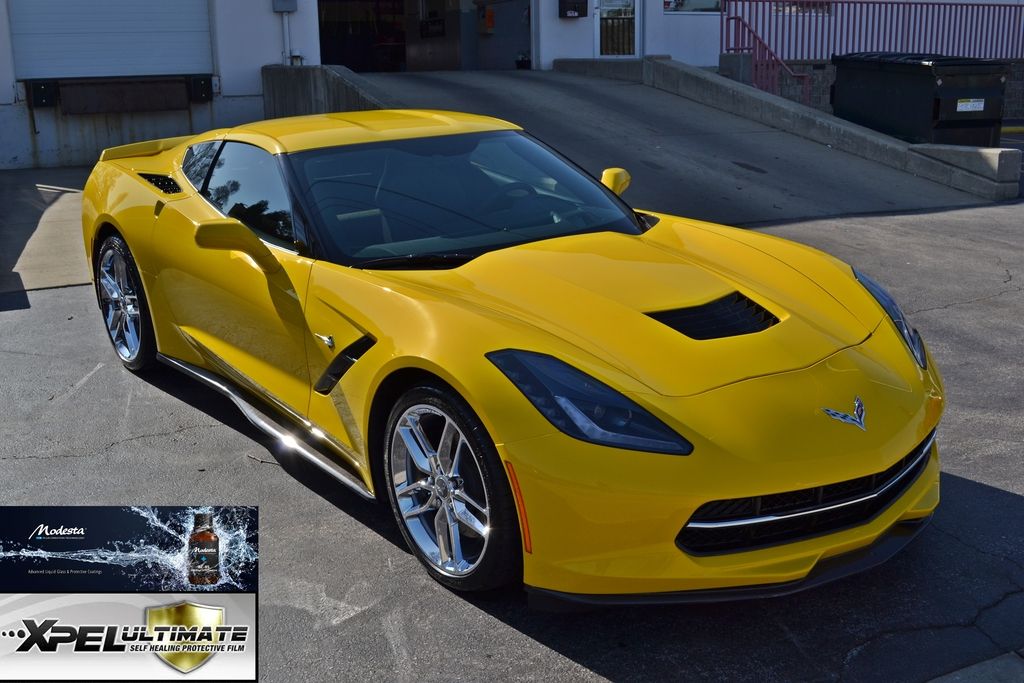

So for this vehicle we have a full custom cut wrap of the entire front clip with the addition of a full rocker panel kit, full roof and a-pillar kit, and a custom piece behind the rear tire to negate any stones kicked up at high speed as this car will be driven and hard! We topped off the paint protection film with our Modesta BC-04 full exterior protection package utilizing BC-06 on the wheels with removal and application to the brake calipers as well. We finished off this C7 with Llumar Ceramic 50% tints on the side glass to keep the driver cool as he blazes down the street.
First things first the car arrived fresh from Bollingreen KY where the owner was able to be a part of the production process and take delivery the right way at the National Corvette Museum. Upon arrival the vehicle was inspected panel by panel to determine how much paint correction was needed and then went on to be fully decontaminated and washed in preparation for the XPEL Ultimate application.

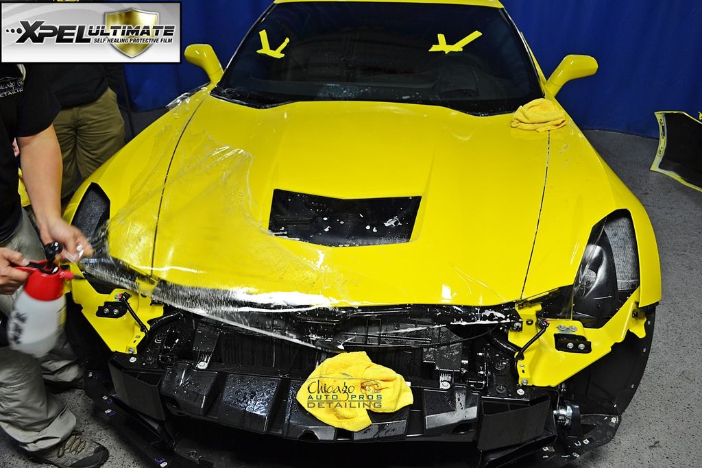

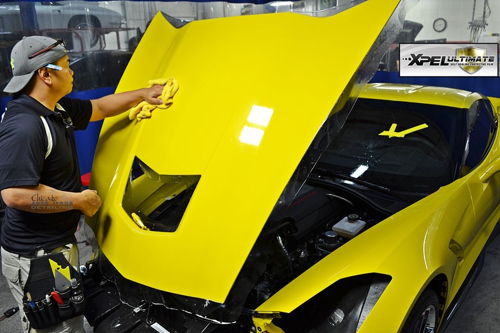

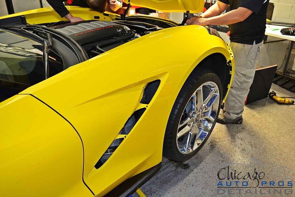

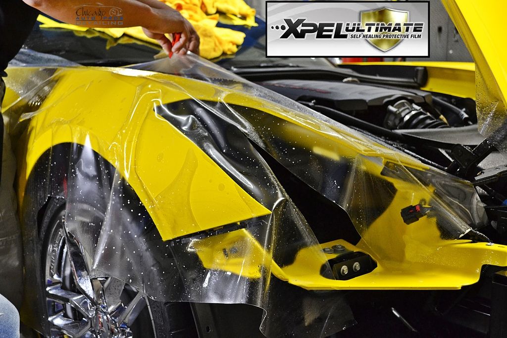

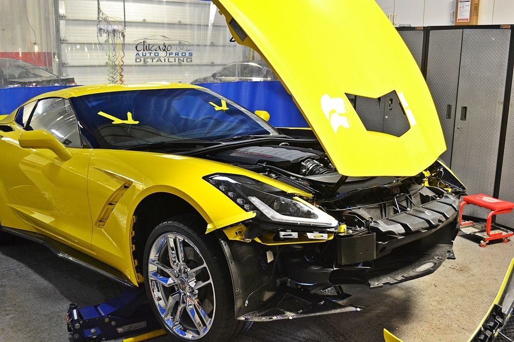

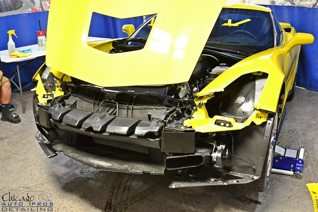

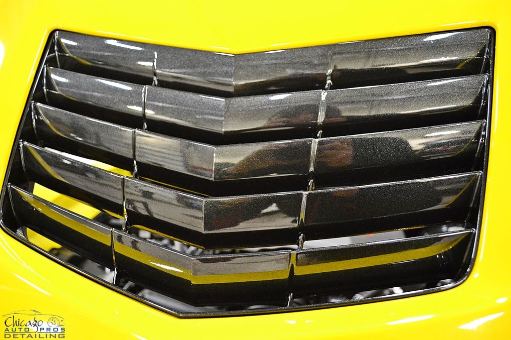

After it’s bath the vehicle was then corrected here in house to perfection and then was meticulously stripped down piece by piece to expose all of the seams where film would be wrapped inside. The hood vent, side vents, full undertray, and front bumper were removed.

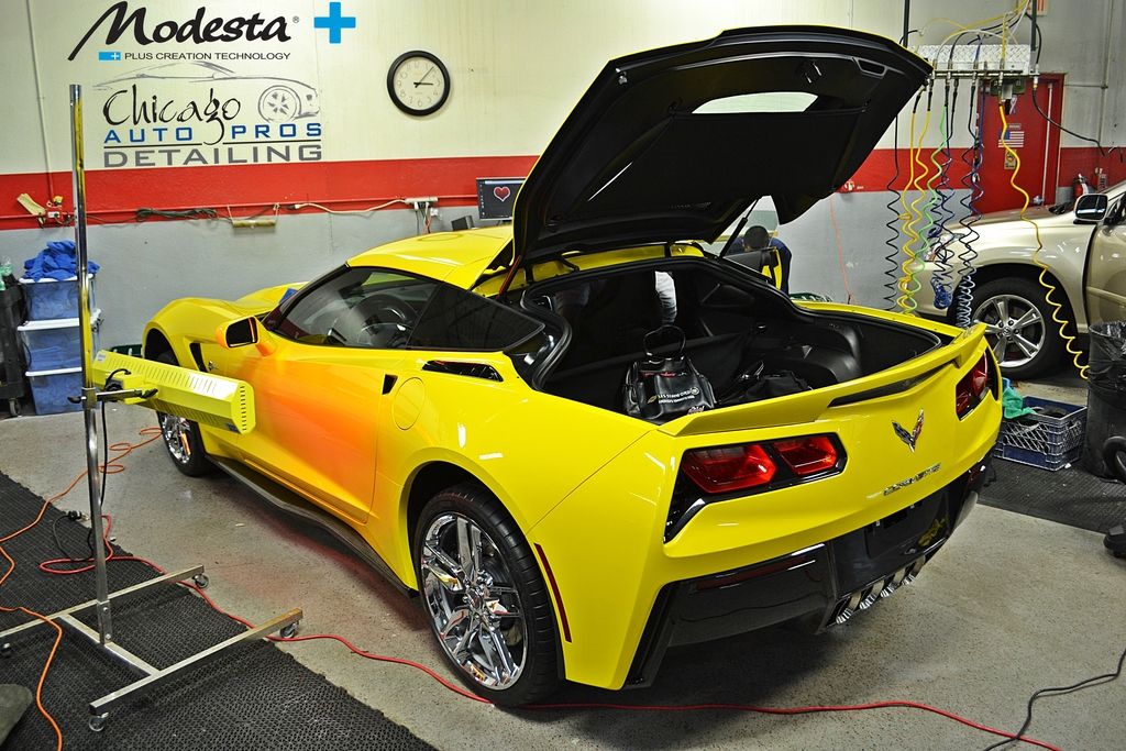

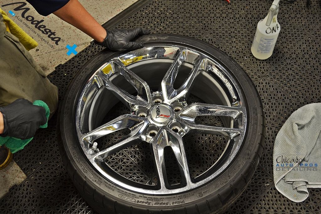

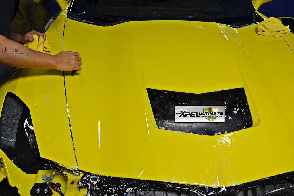

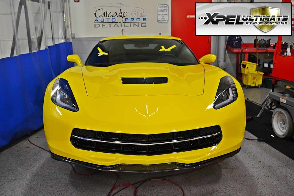

We then separated the grill from the bumper and the front lip from the bumper and began applying the XPEL Ultimate. Once the entire vehicle was wrapped it was full reassembled as per factory spec with no missing hardware or extra bolts left over, you know, the right way. We picked up new Stingray badges and the Corvette Flags from the dealer for the front bumper and fenders to replace the ones we removed. The vehicle was then re-inspected and primer polished using Modesta P01A and left to cure. It then received an IPA wipe down to remove any oils or solvents left from polishing and then the entire vehicle was coated with Modesta BC-04, the glass received an Opti-Glass treatment, and the wheels and calipers were sprayed with BC-06. Everything cured under IR lights for the proper time at the correct temperature and man did this thing shine!
This is the ultimate way to protect a car you love, no vehicle can have a force field around it at all times but this is about as worry free and as close as you can possibly get. It’s hard to find the right words to describe this vehicle in person, but the word “perfection” is the first to come to mind with seamless XPEL and a Modesta Glass coating to make this C7 like none other on the road. Up next is a beautiful black Z06 in for the same treatment.
