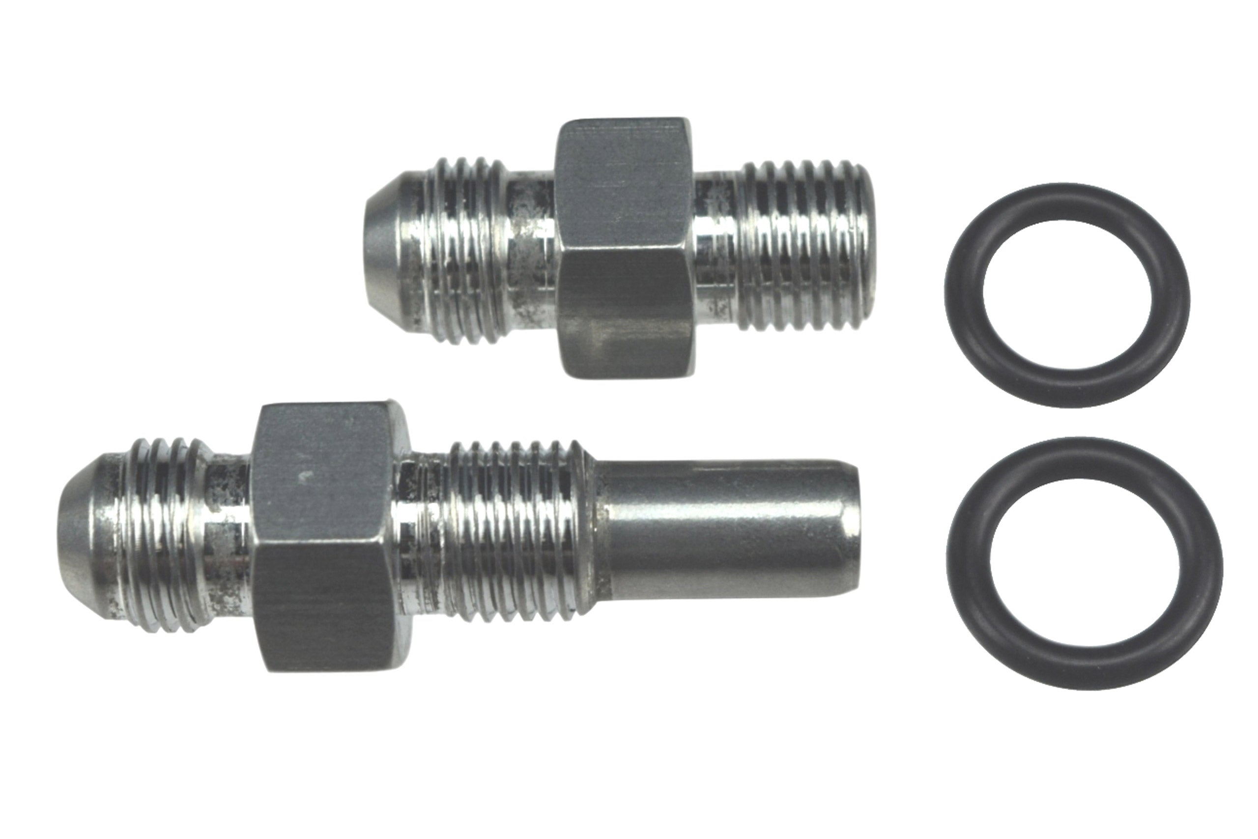

What are you guys using to hook the trans cooler lines to the trans? I got essentially the same kit as below:
With the trans in the tunnel, I have like 1/2" clearance. To get these fittings and the associated AN fittings to fit, I'd need at least 2". I really dont want to cut a hole in the trans tunnel. Not sure I could get 2" out of a BFH.
Any suggestions?

I'm just going to select thumbnails since its 3 pictures but if you click on it you should have better resolution to see the actual part numbers. I made sure to include the one that includes a standard an -6 fitting Style.
The stainless units were a little fatter and gave you a little more room between your hose end hex and the case for our 4T80e.
Hope that helps

Do me a quick favor if you would and post a picture of the stand out of the unthreaded portion of the banjo bolt of your factory case port and the new banjo fitting that you buy. None of these things seem to have the exact same length but from what I recall of the case Center support it really doesn't matter as long as it goes all the way in past the case to Center support transition.
It's just a curiosity thing for me between the 4T80e and the 4L80e I guess but it would calm my ass burgers
