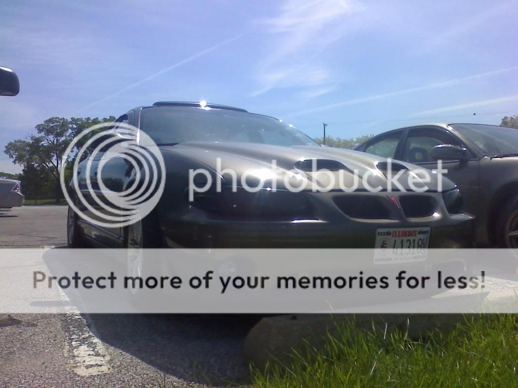

i havnt ran her at the track yet so it is real hard to say...... when we tuned her the timing is set around stock so i can still use her as an everyday car which i am. with the 347whp i average 20mpg but on the interstate it ranges between 22-25. so turning her up wont be a problem you see im only at the begining of the potential of this motor.
