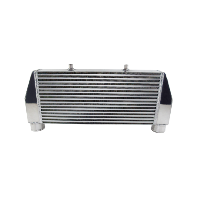

I took the car out for a long ride around the city last week. Gorgeous night for a drive with air temp in the 80s, but beating on the car on the thruway I was seeing 240F IATs at the end of a pull. Even cruising for extended periods as the evening cooled down they never went below 120. I realized I was spending a ton of time staring at the handheld worrying about IATs, so I decided it was time to do something about it.
The reason I never installed an A2A in the first place was a lack of space, and mostly me using the parts I had laying around. The truck water pump worked but needed a bunch of adapting to fit. Old FEAD setup: Truck accessories/WP, bunch of 90s and hose splices to route the top rad hose under the turbo outlet. Overly complicated and took up a bunch of space.
The LS3 (2010 Camaro) water pump has the outlet in the front with truck spacing, but was about the same price as buying an LS1 Camaro pump, new Camaro top hose, new tensioner, 2 sets of gaskets, and the water pump spacers (.700"). So...
Tore it all apart, removed some of the plastic bumper shrouding between the hood and the bumper. Made up some new tabs to mount the bottom of the radiator isolators. The whole radiator/fan assy got shifted back 2-3". The radiator was previously mounted dead center (fore/aft) on the lower rad cradle, whereas now the front of the rad is flush with the rear face of the crade.
Few more shots showing the movement. It's best visible looking at the cutout for the rad filler cap.
The other issue is that the belt now rubs ever so slightly on the bottom of the intake coupler at the throttle body. I can probably find a smaller tensioner pulley in a catalog to bring the belt away.
I'll have to figure out something for the header panel, chop out the middle section or something. The plan is to throw in one of these now that I have room:
3" aluminum charge piping will run up and over the top of the radiator.
Plenty of room now:

Making room for the A2A IMO was way easier than running all those water lines, wiring, fittings etc for an A2W, at least in this application. Plus the cost of buying a pump, relays, wiring, plumbing, tank, etc. A2A is just so much simpler

I also finished up the intercooler install. IATs are now nearly ambient (perhaps 20F above, after a pull) rather than 240F.
